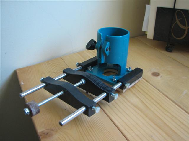

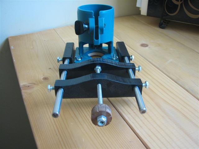

Well, I took coach Tony's (as Serge would say) advise and instruction's from circle cutter details topic and built one for myself. It is slick, I just finished it up this morning and it is soooooooo much better than the plywood plate I was using.
Thank you, Thank you, Thank you Tony.
Here are some pics.

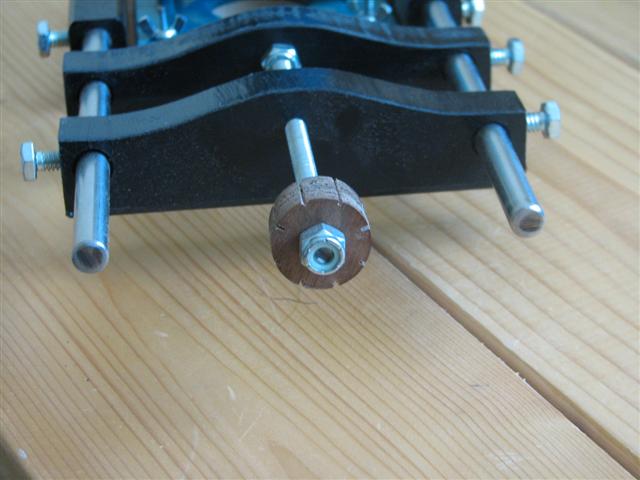

I cut a little walnut turn knob for it and cut some little grooves in it as suggested by Dennis E in the original post. Thanks Dennis.
I just love this place. Thanks again for all the great ideas around here everyone.

I love that tool
It looks professionally done!

Very neat Rod, WOW! What Joe said, real pro job!
PostPosted: Sat Oct 07, 2006 5:48 am
Nice job Rod! What is the black stuff you used?

Thanks Guys, Of course nothing is ever perfect the first time out right.

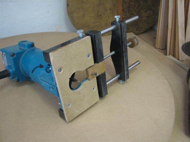

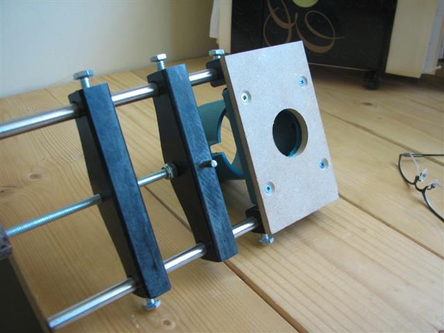

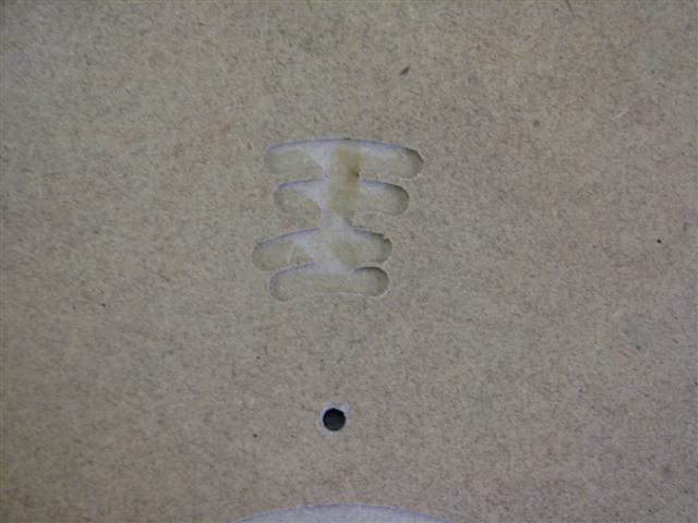

Well I went to go and cut a rosette channel with it and looking at the layout on the top, I took a second look at the base and realized that I couldn't cut a small enough soundhole. Well, I had to make a slight modification so here it is.
Now I can cut as small as 2" dia and it increments very well.
This is a pic of the test cuts after the modification. 3/16" pin hole and 1/4" cutter bit.

I really must insist that Tony Karol gets the credit for this fine tool, his tool is my inspiration. As he would probably say that Richard Schneider was his inspiration to build his.
I do a little bit different than Tony's, which is the way it should be. I used 3/8" stabilizer rods on mine as I felt that 1/4" was to wimpy.
I will be happy to have it in the jigs tools & techniques section if Lance and Brock want to put it there.
Oh and Dave Rector, the black material is UHWM. Got it from a local plastic tank manufacturer.
Total cost to build this is about $5-$8.

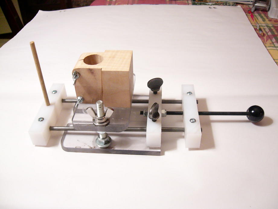

Here's the version I built from an article I found in a Big Red Book. Mine is built to hold the shaft of my Foredom When I posted mine it spurred some debate from the venerable MichaelP as to whether it would work
Let us know how you like yours.

Serge I have another base for the jig shown above that I use for cutting my inlay pockets. I just remove the top part (which has the wood block on top) and attach it to a small base I have. Works great -- essentially 1 jig - 2 purposes.

Anthony, your's looks like it would work just fine, and I bet it does.

Thanks Anthony, really cool, i do have a Dremel foredom(?) and i will have to get it working for me then!
